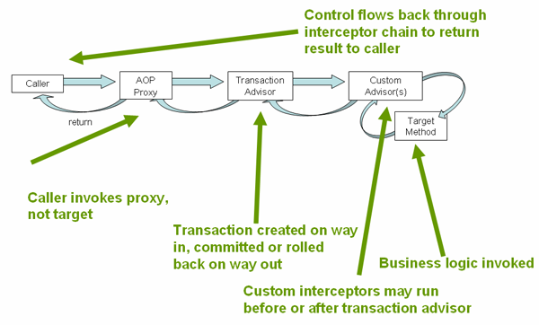

The most important concepts to grasp with regard to the Spring Framework’s declarative transaction support are that this support is enabled via AOP proxies and that the transactional advice is driven by metadata (currently XML- or annotation-based). The combination of AOP with transactional metadata yields an AOP proxy that uses a TransactionInterceptor in conjunction with an appropriate TransactionManager implementation to drive transactions around method invocations.spring-doc.cn

The following image shows a conceptual view of calling a method on a transactional proxy:spring-doc.cn
