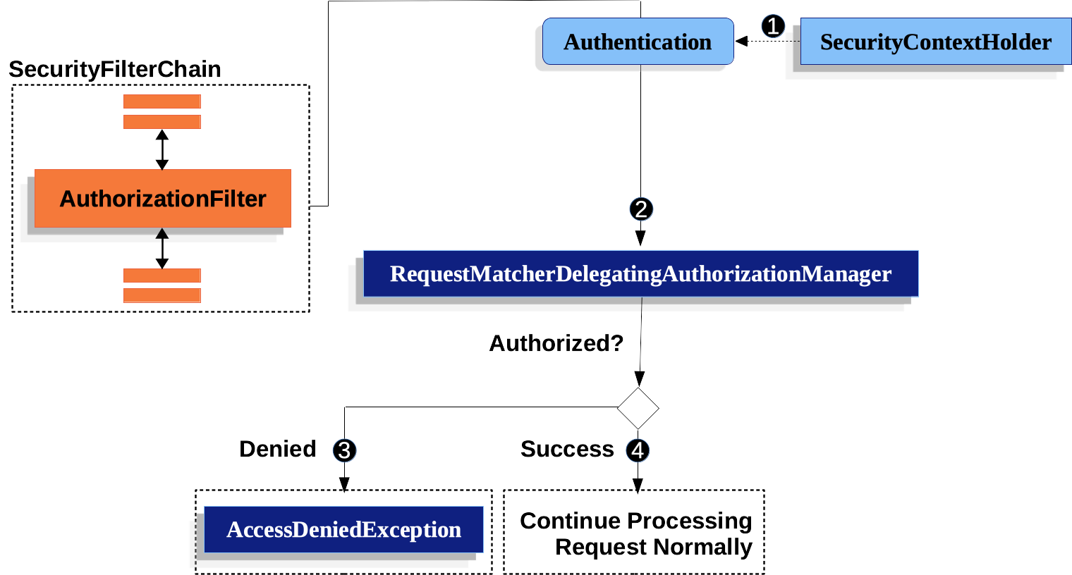

When authorizeHttpRequests is used instead of authorizeRequests, then AuthorizationFilter is used instead of FilterSecurityInterceptor.spring-doc.cn
authorizationfilter
Figure 1. Authorize HttpServletRequest
We can configure Spring Security to have different rules by adding more rules in order of precedence.spring-doc.cn

.requestMatchers("/test/**").access((authentication, context): AuthorizationManager<RequestAuthorizationContext> ->
    AuthorizationDecision(webSecurity.check(authentication.get(), context.getRequest())))
For complex instructions that include bean references as well as other expressions, it is recommended that you change those to implement AuthorizationManager and refer to them by calling .access(AuthorizationManager).spring-doc.cn
If you are not able to do that, you can configure a DefaultHttpSecurityExpressionHandler with a bean resolver and supply that to WebExpressionAuthorizationManager#setExpressionhandler.spring-doc.cn
