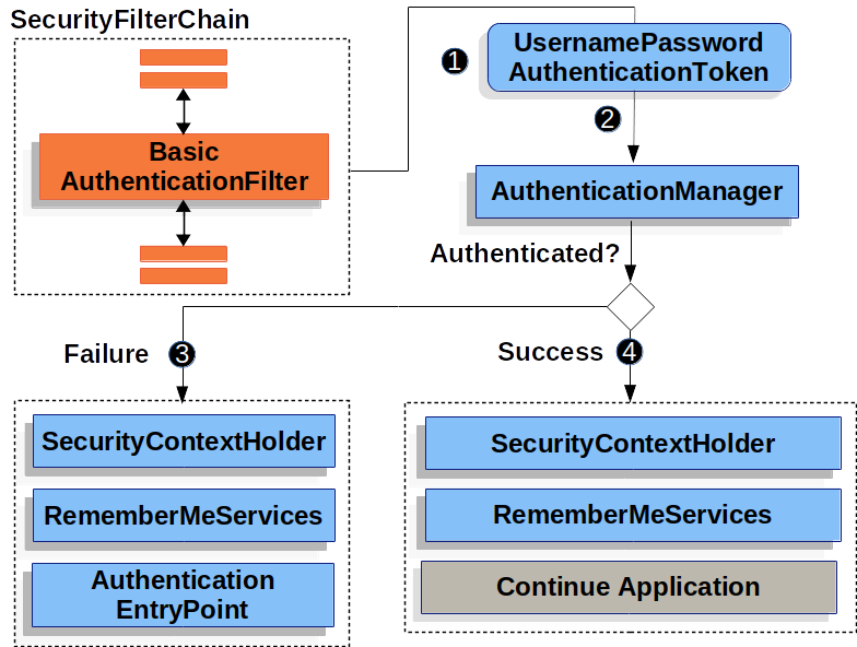

When a client receives the WWW-Authenticate header, it knows it should retry with a username and password. The following image shows the flow for the username and password being processed:spring-doc.cn
basicauthenticationfilter
Figure 2. Authenticating Username and Password
The preceding figure builds off our SecurityFilterChain diagram.spring-doc.cn
number 1 When the user submits their username and password, the BasicAuthenticationFilter creates a UsernamePasswordAuthenticationToken, which is a type of Authentication by extracting the username and password from the HttpServletRequest.spring-doc.cn
number 2 Next, the UsernamePasswordAuthenticationToken is passed into the AuthenticationManager to be authenticated. The details of what AuthenticationManager looks like depend on how the user information is stored.spring-doc.cn
number 3 If authentication fails, then Failure.spring-doc.cn
  1. The SecurityContextHolder is cleared out.spring-doc.cn
  2. RememberMeServices.loginFail is invoked. If remember me is not configured, this is a no-op. See the RememberMeServices interface in the Javadoc.spring-doc.cn
  3. AuthenticationEntryPoint is invoked to trigger the WWW-Authenticate to be sent again. See the AuthenticationEntryPoint interface in the Javadoc.spring-doc.cn
number 4 If authentication is successful, then Success.spring-doc.cn
  1. The Authentication is set on the SecurityContextHolder.spring-doc.cn
  2. RememberMeServices.loginSuccess is invoked. If remember me is not configured, this is a no-op. See the RememberMeServices interface in the Javadoc.spring-doc.cn
  3. The BasicAuthenticationFilter invokes FilterChain.doFilter(request,response) to continue with the rest of the application logic. See the BasicAuthenticationFilter Class in the Javadocspring-doc.cn
