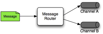

Message Router
A message router is responsible for deciding what channel or channels (if any) should receive the message next. Typically, the decision is based upon the message’s content or the metadata available in the message headers. A message router is often used as a dynamic alternative to a statically configured output channel on a service activator or other endpoint capable of sending reply messages. Likewise, a message router provides a proactive alternative to the reactive message filters used by multiple subscribers, as described earlier.spring-doc.cn
Router
Figure 3. Message Router

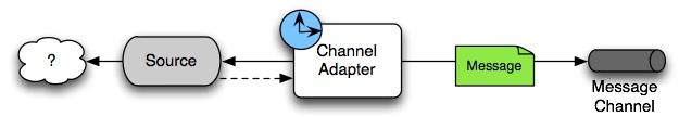

Channel Adapter
A channel adapter is an endpoint that connects a message channel to some other system or transport. Channel adapters may be either inbound or outbound. Typically, the channel adapter does some mapping between the message and whatever object or resource is received from or sent to the other system (file, HTTP Request, JMS message, and others). Depending on the transport, the channel adapter may also populate or extract message header values. Spring Integration provides a number of channel adapters, which are described in upcoming chapters.spring-doc.cn
source endpoint
Figure 5. An inbound channel adapter endpoint connects a source system to a MessageChannel.
Message sources can be pollable (for example, POP3) or message-driven (for example, IMAP Idle). In the preceding diagram, this is depicted by the “clock” symbol and the solid arrow (poll) and the dotted arrow (message-driven).
