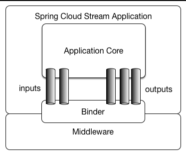

A Spring Cloud Stream application consists of a middleware-neutral core. The application communicates with the outside world by establishing bindings between destinations exposed by the external brokers and input/output arguments in your code. Broker specific details necessary to establish bindings are handled by middleware-specific Binder implementations.spring-doc.cn
SCSt with binder
Figure 1. Spring Cloud Stream Application
