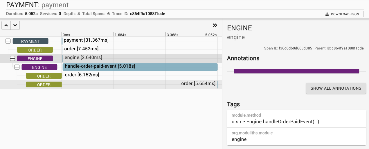

This will cause all Spring components that are part of the application module’s API being decorated with an aspect that will intercept invocations and create Micrometer spans for them. A sample invocation trace can be seen below:spring-doc.cn
observability
Figure 1. A sample module invocation trace
In this particular case, triggering the payment changes the state of the order which then causes an order completion event being triggered. This gets picked up asynchronously by the engine that triggers another state change on the order, works for a couple of seconds and triggers the final state change on the order in turn.spring-doc.cn
