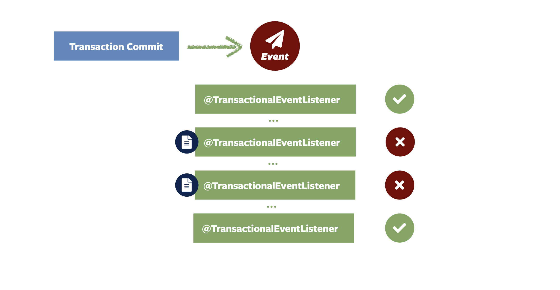

The Event Publication Registry
Spring Modulith ships with an event publication registry that hooks into the core event publication mechanism of Spring Framework. On event publication, it finds out about the transactional event listeners that will get the event delivered and writes entries for each of them (dark blue) into an event publication log as part of the original business transaction.spring-doc.cn
event publication registry start
Figure 1. The transactional event listener arrangement before execution
Each transactional event listener is wrapped into an aspect that marks that log entry as completed if the execution of the listener succeeds. In case the listener fails, the log entry stays untouched so that retry mechanisms can be deployed depending on the application’s needs. Automatic re-publication of the events can be enabled via the spring.modulith.republish-outstanding-events-on-restart property.spring-doc.cn
event publication registry end
Figure 2. The transactional event listener arrangement after execution
